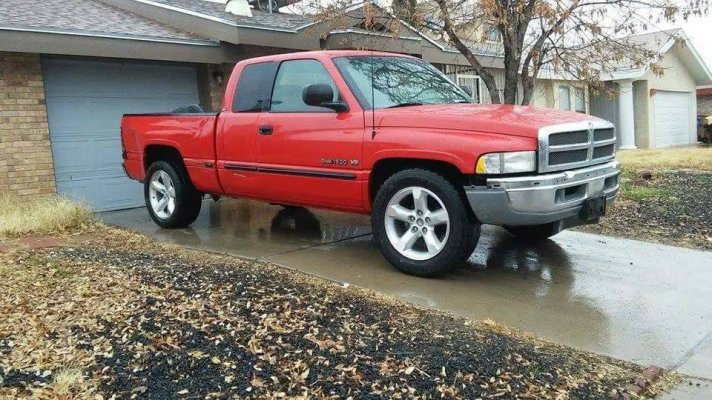

I've got a 98 ram 1500 Laramie SLT limited with an engine that isn't good. I'm wondering how easy it would be to swap in a 5.9 instead of the stock 5.2. The drivetrain is an automatic with OD and rear wheel drive.778dc814fb9e043245ae919fab7bea29.jpg

My truck has the stock wheels, the front passenger is that spare, but the original is in the bed.
