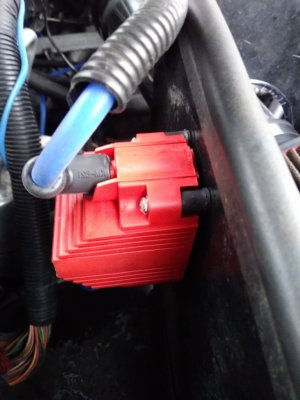

I have limited it down to the heads being cracked and the valves being caked in carbon. I did a running compression test about a week(ish) ago and can see that a couple cylinders have a bunch of overlap during the compression cycle, which I am thinking is why my cylinders have been having issues. So my plan is to swap heads, lifters, rockers, push rods, cam, and modify my TB.You also can't be sending a pulse to every cylinder, physically impossible with the way the distributor works. What you can have is frequency transfer between wires that creates its own pulse and the fix for that is wire looms or tsb style routing. Thicker more insulated wires also does the trick
