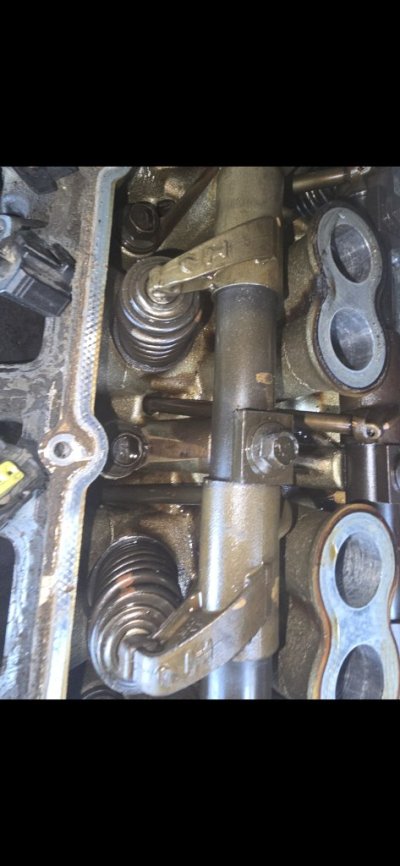

I have good spark fuel , injector, coil pack and i got the pcm checked by the dealership. I have a 2011 ram 1500 5.7 with 330k km. I have a p0303 misfire I can't figure out. I changed my intake and valve cover gaskets did a leakdown and compression test and vacuum test and everything came back with great results. I hear 0 ticking either. I noticed looking though pictures after I got the valve cover back on that cylinder 3s valve spring and rocker arm sit significantly lower than the others could this be a worn spring? Such a simple fix it hope it is should all the rockers be sitting at the same height?

Cam and lifter job looks to be in your future.

What makes you say that. Could the valve spring potentially be the issue?
Your comment about the rockers on 3 not being the same as the rest,that usually means either the cam lobe or lifter is toast.If you got a little over 200,000 miles out of it,you've done good,time to spend some money on it.

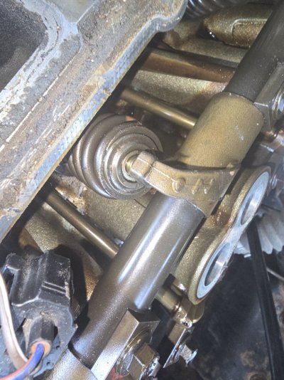

When i was talking about the rocker I only meant that it's on a different angle as scene in the picture there is no jiggle or play in the rocket at all it's tight and snug just the pring it's self looks to be more compressed.
Well it would look compressed if the lifter is on the tip of the lobe.So you didn't actually rotate the engine over with the valve cover off to see if all the rockers are moving roughly the same amount. Usually a broken spring is spotable if you look them over close.You should probably remove that valve cover again,and rotate the engine over while watching the rocker arm movement.

If the spring is sitting more compressed than the other cylinders and it's not from the rocker pushing on it, then it's a good chance the valve seat is dropping and you caught it before it dropped all the way out and became catastrophic.

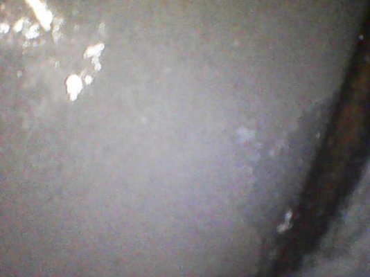

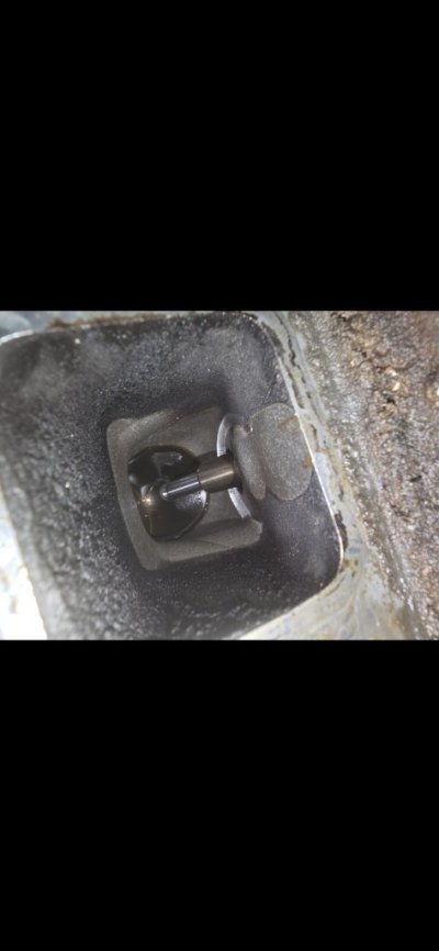

I checked the cylinder head with bkre scope leak and compression both good ugh it must be a worn cam and lifter :( can't test for another 3 weeks as I work away from home...

Could it be a leaking valve stem seal even though the leakdown test and compression test where good ? Here's a picture of the valve and cylinder for 3 the misfiring culprit.1000002075.jpg1000001915.jpg1000001915.jpg

Pull that valve cover again,and either jump the starter relay,or have somebody turn the engine over on the key while you watch the rocker arm movement. I think you're grasping at straws with your ideas of what causing your misfire,there's a very good chance you've fallen victim to the infamous bad cam/lifters the hemi has a rep for.
