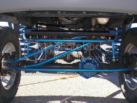

I remembered why I was asking now...
I keep running across THUREN parts.
I assume they make heavy duty steering and suspension parts.
mostly only 2500 series and up would need something like this??
wermbang
Jun 29, 2010
9,724
215
Iowa
2001 Off Road
5.9L V8 Sport
this is on a 1500, and a huge lift, but its Thuren Fabrication Steering and Track Bar
