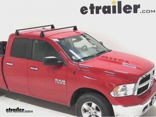

I think Yakima makes roof rack bars for 4th gens that basically grip the drip rails without drilling, and they are rated for a couple hundred pounds. Doesn't seem like it would be that tough to make a tube-mount setup to mount a light to them. They would set back a bit further, but it would worth a try for the drill-shy among us - myself included. They are sold as 4 or as pairs.
They look like this:
http://www.yakima.com/shop/rack-systems/naked-roof/q-tower-pairs
