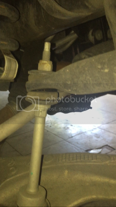

Sorry to keep hi-jacking this thread but I went and looked at mine again. It looks like your sway bar link is at a different angle than mine. Is this something I should fix?
