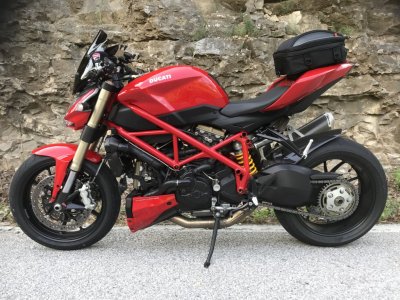

Man, that RSV4 is too much motorcycle for me. I was at Commonwealth in Louisville. They had a couple of those on the showroom floor. Beautiful. I'll stick to my little 848 Duc.

That 848 is beautiful!
My RSV4 is a 2012 Factory APRC. I've modified just about everything on it. Motor is about the only stock thing, it's a trackday/ street bike. I'll post pics when she is 100% complete.
