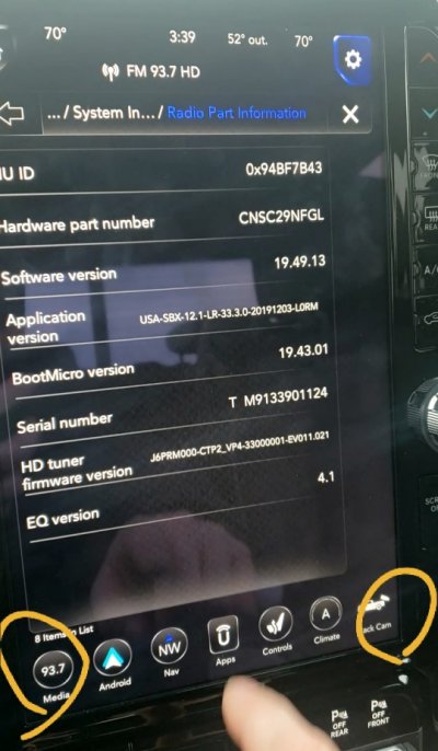

My truck info :
- 5th Gen 2019 Ram 1500 Laramie
- 12" UAX radio
- HW PN: CNSC29NFGL
- Application Version: v 33.3.0
(USA-SBX-12.1-LR-33.3.0-20191203-LORM)

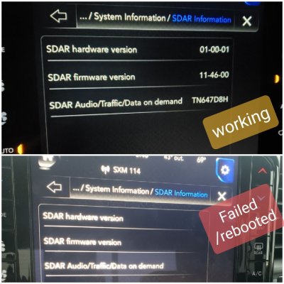

** I do believe that the issue is related to the SXM/Satellite module (SDARS) which faults out and causes the Reboot. Specifically...
>> If I go into DEALER MENU when SXM is working, you can see that the Following info is populated....
- SDAR hardware version: 01-00-01
- SDAR firmware version: 11-46-00
- SDAR Audio/Traffic/Data on Demand: TN647D8H
>> When I check this screen after it faults out/reboots ... SXM is greyed out & " Unavailable" it doesn't show any SDARS info (Just blanks):
** To access DEALER MENU : hold the 2 Lower, Outside App Icons at the bottom of the screen for 6-10 secs **

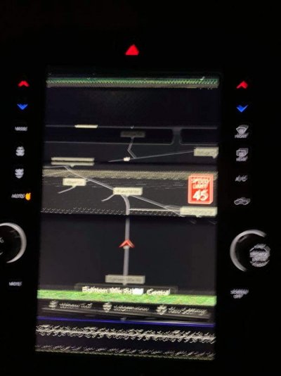

Screenshots:
Dealer Menu - Radio Info
Dealer Menu - SDARS info
Screen Error switching from AA to Nav

Where are all you 5th Gen 12" UAX Owners at?
Just curious if you all have the same blank info on the SDARS page when it faults out and that you have the same symptoms.

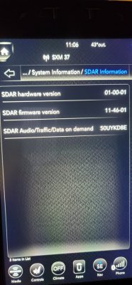

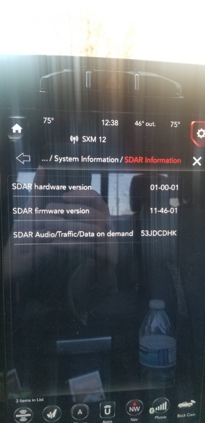

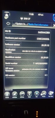

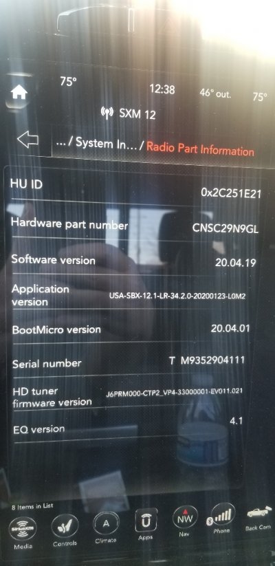

@LeesEvoX @Arth
Any chance you can post pictures from the dealer menu of your radio info screen showing radio HW PN, application version etc as well as your SDARS info screen?
I'm curious what the current versions are for the 2020 and 2021 units.
M² Mods.

Hemi 6.4l
Looks like the hardware version on the SDAR is updated on mine.
Along with the software, an bootmicro on the radio information

Now to see if @Arth will post his radio info and mileage for his 2021. Just trying to compare SW/FW/HW PNs.
I've read (elsewhere) some of the 2020's still have issues with the UAX radio like the 2019's...
Haven't seen much feedback on the 2021.

Here's what I've got on my 2021. 8k miles.
