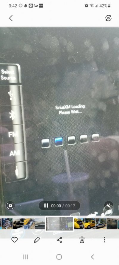

Got my truck back yesterday with the radio module replaced. We'll see how it goes.Just started to have the same issue. Sirius won’t connect, and no access to am/fm/Bluetooth. Works fine then goes out and back again. Referred to SiriusXM and they’re troubleshooting but based on your comments it sounds like a radio issue. Guess I’ll try Ram customer care and schedule a visit to the dealer. Of. Course the radio will work when I go and they’ll say they we unable to replicate the issue.
If you can determine that it takes a specific amount of time like I did to occur/replicate it (20-35 mins of run time)... That will help them to troubleshoot it and you to verify it's fixed later.
I had to leave my truck with the dealer for almost a week for them to test/troubleshoot with the Star Case techs before Star would recommend the radio replacement.
