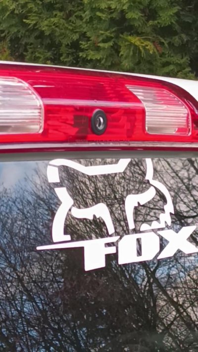

I created my own cargo camera with an aftermarket button camera.
If you remove the third brake light, you can fish the wires out through the headliner, and then run them along the back window under the headliner and the door trim to the dash; making the wires invisible.
It fits perfect, and looks like it was meant to be there. If you have in dash video you could wire it up to the aux av in, or even get one of those mini monitors that are the size of a GPS, Or even a rearview mirror with the video screen built in.
This is the only photo I have from during the install. I was thinking of doing a DIY if people were interested.

Question: Wouldn't removing the third brake light be illegal in many states?
I was referring to removing it to mod it and run wires through the service hole at the back, not removing it permanently.
The DIY camera mod keeps both white cargo lights as well as the center red brake light functional.
