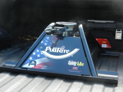

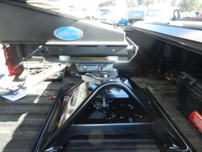

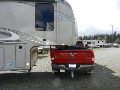

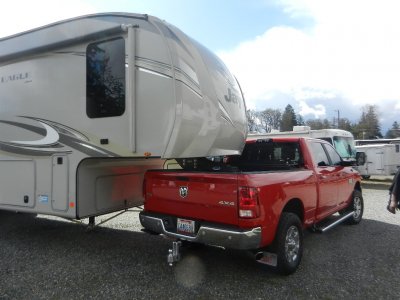

DSCN3356.JPG DSCN3364.JPG DSCN3364.JPG DSCN3398.JPG DSCN3402.JPG DSCN3394.JPG I have the PullRite Superlite #2600 with the SB and tow my 5th wheel a lot depend on the front cap of you 5th wheel.
