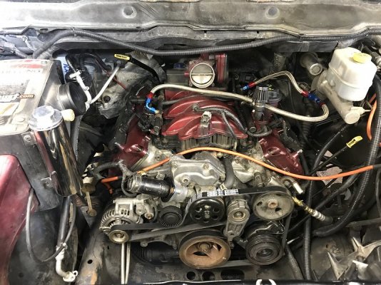

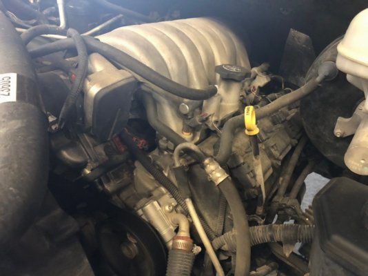

21e8f3eb1faefcd00c2e6feeb27a5fac.jpgfca631a1f3e3bdf0f2aa9de4b6667dc0.jpg7f916f2d07e8649ebfa6c3e9407bff45.jpg
Not the best pictures, but here’s an 06 ram that came in and was 6.1 swapped
Max1329
Max1329
Aug 9, 2018
177
30
33414
2005
5.7 Magnum hemi
Any clue what he did with the ac/alternator?
