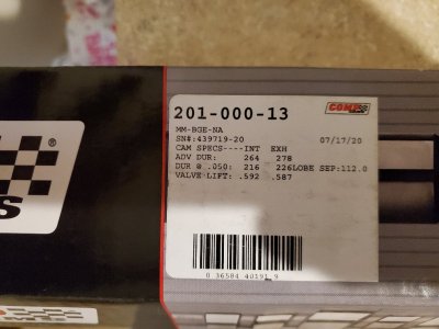

I can give you good answer since that's exactly what I did. I purchased the MMX BGE camshaft on their recommendation:
https://www.modernmusclextreme.com/p-1431-64l-hemi-performance-camshaft-kit-bge-ram-na-by-mmx.aspx
They advertise a lift (.592/.552) but what came on my cam card is slightly different. If you compare this to what's been posted online for the SRT 6.4 cam (duration at .050 215/221, lift .574/.541) it actually appears to be slightly more aggressive. Even though it's advertised as a truck cam.
The kit itself lists for $1700 but when you add everything else in that's required to complete the swap it's almost $2200. Heads need to be removed to do a lifter swap so book time for a complete cam/lifter install is about 21 hours, not including springs. I also installed a Hellcat oil pump so the pan needs to come off, otherwise it's not necessary. Obviously if you're doing the work yourself none of the labor times matter much.
