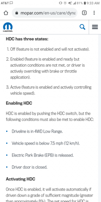

My 2017 6.4 has a button by the tow haul to shut hill descent off. Is yours off? Mine will kick in only if I depress the brake going down a hill. Then it drops into a lower gear to help but its high RPM's. Scared me the 1st time it did this.

My truck when towing my 5th wheel will hold back within a 10mph range. Recently I was on a trip going down a 7% grade and wanted to go 55 max speed so I bumped the cruise down to 45. The tach jumps up and down as the gears change and it has consistently held me to 10mph over set cruise speed. I have never been down to 1st, usually 3rd, once in a blue moon 2nd. I have the 6 speed and I run in Tow Haul Mode.
I don't like the engine revving to 5k, but I am okay with it as long as it is holding the speed within the 10mph range and I believe I need it to be safe as I descend down the hill.
What is quirky is when I know I no longer need/want the engine at high rpms (5k) I tap the brake or cancel the cruise it will not always stop the high revving the truck was doing. When going up hills and the engine starts revving high I sometimes hit the brake and it stops the high rpms right away.
My truck is a gasser and I don't always need it to maintain speed up hills at the cost of revving the **** out of it! I can go slower and let it shift down to where it doesn't have to rev so high!
My truck is an Off Road and has the hill descent (HDC), but I never use it while towing because my understanding it only works in low range and speeds under 40mph. My towing is on the highway and not off road.
