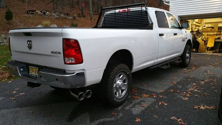

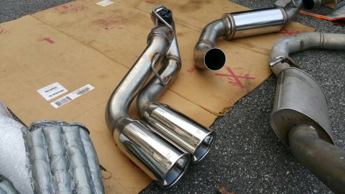

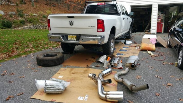

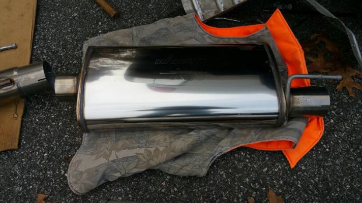

I put a Magna Flow cat back on my '17 2500 CCLB. It's still a single exhaust, but I opted for the dual outlet. It has it's own resonator. Muffler is much smaller and lighter. It's 4" all the way with 5 " dual tips. I'll try to do a short video tomorrow. I also have a K&N CAI so, you'll hear some of that as well. Not too loud but not stock by any means. When I installed it, I ran the truck with nothing past the Y pipe and it still wasn't loud.

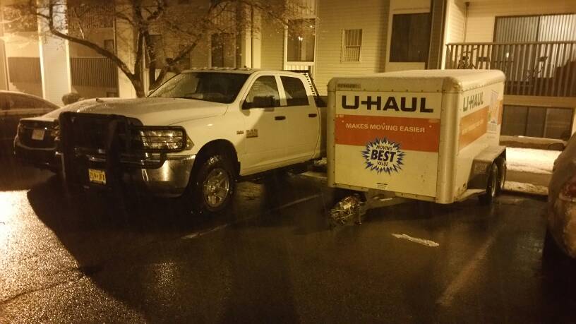

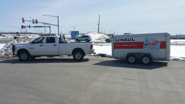

I think so, but I'll have to measure it. Didn't really think much about it 'cause it was a complete kit.
The only thing I've towed is an enclosed 6'x12' U-Haul double axle trailer that was way overloaded both times. Trucks 8' bed was full as well as front & back seats.
Made 1 trip from NJ to VA and back.
2nd trip was NJ to VA to TN then back to NJ empty.
There's a narrow RPM range just above idle to about 1500-1600 where it kinda drones but once you hit 2k it is quiet. These trucks like to run at 2000-2500 RPMs.
I shift into "manual" mode and run with Tow/Haul mode on. The only time I see 6th gear is when it was empty and I was running 75 mph. T/H mode off will allow upshift into 6th. Thats about 2200-2400 RPMs at 75. I like to hear my truck anyway. This is all with 4.10 gears. Yours may be different.
I'm actually contemplating a muffler delete pipe once I get moved to TN. Wasn't able to record video today. I' try tomorrow and also measure the muffler. Hope this helps. Ed.

Nice looking exhaust RR. I like it!
Good looking push bar too!
