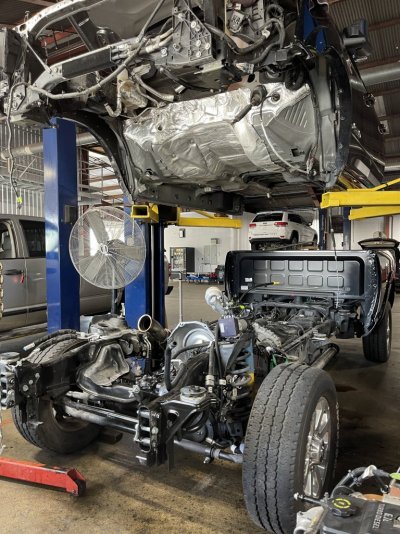

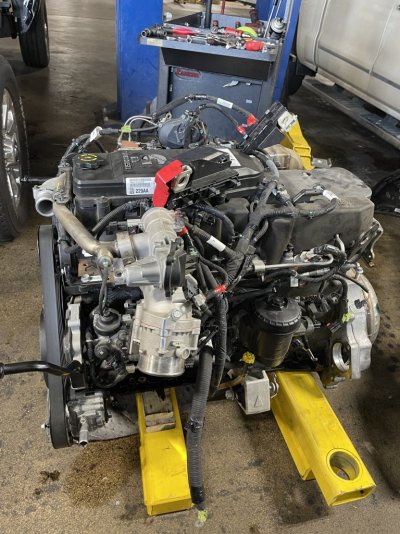

Here is the latest;
Engine tear down was completed and after many calls to both Ram Care and the dealership, they were kind enough to replace the engine. After receiving the motor, they forgot to sent the torque converter so here I am driving a caravan and no truck. My camper need to be serviced because of a broken window and other issues. I pointed out that they are spending more money on this compared to just giving me another truck. I’m so over this!

Guy, that’s not a tow hook. When have you seen a tow hook inside the engine bay??‍♂️
lol yea If it was bigger after examination it does look like a cab chassis tow hook. but looking harder at the scale I am 10x off. thx for pointing out my disarray.....

does some of the pictures show the crankshaft with a busted rod or what happened to the engine? looks like a major failure for sure.. at least you get a new motor and it sucks this take so long to do. would be nice to get a "bill of rights" that requires the manf to replace the truck with a new like model and rebuilt/replace on their dime and time.

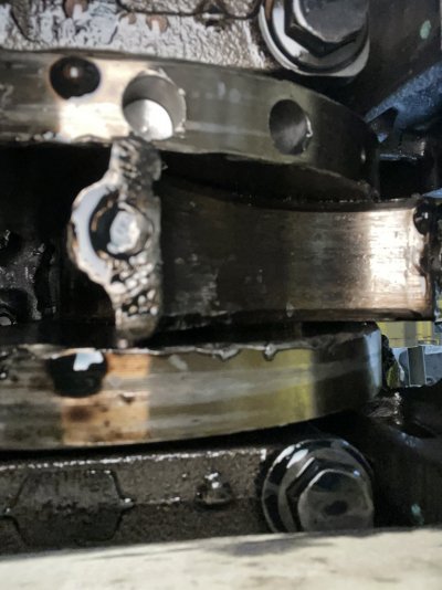

Here is what failed. I just got my truck back last week with a new motor and torque converter. 26E84EE4-F541-408F-8D28-6F3DBF2A180D.jpeg5941F094-465B-4D2B-AE8C-8F0E2E1AA7A3.jpeg

This is a failure more specifically to the 2019+ when they changed the block casting and went to hydraulic lifters. Apparently tolerance is too tight on the rod bearings and they seize.
Did the dealer mention it had a broken rod?

I am a little late to the party. The problem that caused this was indeed the new block and that's it. When they did weight reduction to the tune of 74 pounds they removed vital material around the mains. Under load this causes a whole host of issues and the rod bearings close to the main don't get any oil. There is no fix as I understand it. I saw a video from 2021 I think where the same thing happened to a truck with only 4000 miles on it. I think this explains why Cummins is coming out with a completely new 6.7 motor starting in 2025. My guess would be that the company is keeping a fairly tight lid on the whole thing. I for one am not happy at all as I have a 2023 3500 that apparently it is a ticking time bomb. I included the video that explains in great detail why it is happening according to the representative from Choate Performance. Second video is the update that states in the title that they have seen 19+ blocks with holes in them.
