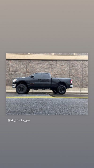

Does anyone happen to have pics of 4" vs 6" lift? I have 305/55r20 (33.2" x 12") tires and I'm thinking I could keep them on a 4", but a 6" I'd have to/want to go to 35" or 37". But, I hear "go to 6 or you'll be kicking yourself". But dang, that's a big added expense.
Also, I'm looking at Zone/BDS. If my truck has 2" Bilsteins, will those come off, or will my truck actually have a 6"/8" lift in front?
White truck zone 4” lift on 35’s
Black truck zone 6” on 35’s
Sliver zone 6” on 37’sE6467958-F832-4C9F-B71E-595D04B174F2.jpegD7F99D6B-B9B7-4C58-94C8-47E0EF45F262.jpeg925E888A-ED16-4C39-90D0-179235677EF6.jpeg

The the 4th gen Trucks zone and bds offered a standard 6” and a tail high kit. The difference being the rear spring is 3” or 5”. On the 5th gen Rams the 4” kits come with the 3” and the 6” kits come with the 5” springs in the rear.
The billsteins set at 2” would leave you nose high with either kit. I would recommend lowering them down. You can use them to take up the preload spacer gap. However a lot of the installers out there can’t seem to follow instructions and just do anything technical wrong.

Thanks! And thanks for the comparison pics!

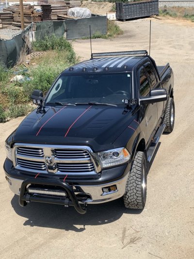

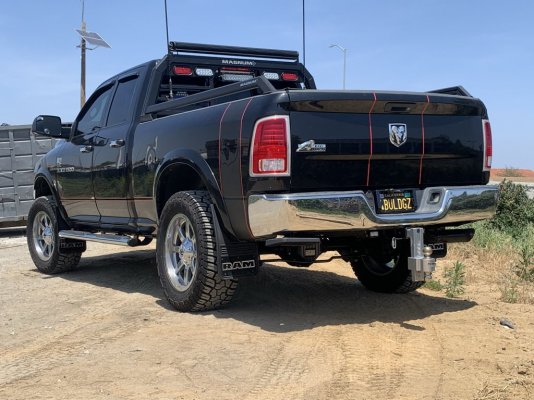

I raised mine to 5” with 35’s and totally happy with it. Then as time went on, as you guessed, I was noticing other Rams that caught my attention with slightly higher lift. Needless to say, I have 7” now, lol.
35’s are fine with either and no rubbing or trimming needed. If I went to 37’s, then ‘re-gearing’ becomes a very real consideration which certainly isn’t a cheap direction to go.
View attachment 494523View attachment 494524
Yer truck came out nice homie !!!! Great decision to go up to 7", I think these trucks look best with 6" and 7" lifts and 35s or 37s ....

I ended up going with 6" BDS w/ 35's (wheels: 20x12 -18).
Looks great.
If you can, tint the front wi does and bring it over the top.
Also….. get your RM in for truck of the month!!!! :waytogo:
Seems like Headache Racks, Roll bars etc are making a new comeback too :favorites37:

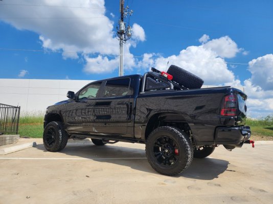

The front windows are tinted to the max TX will allow. This was also peak time for sunlight hitting that wall in front of my truck. Here's a shot from another angle. I have always liked the sport bar w/ lights look (kid of the 70's here). I think I found the TOTM area, but it looks like May was the last month it was voted on?

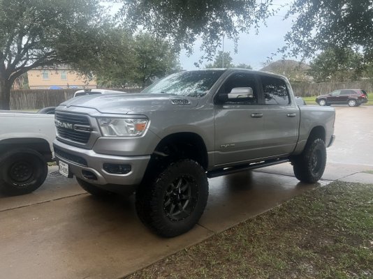

I currently have a 2020 1500 on 38s. I went with a 6inch rough country lift (with struts) a motofab 2.5 leveling kit front and motofab 1.5 leveling in rear. It gave me roughly 8.5-9” of lift. Been running it for about 60k miles.
If you just want some good lift, definitely go 6” and you could clear a 37 with minor trimming.
