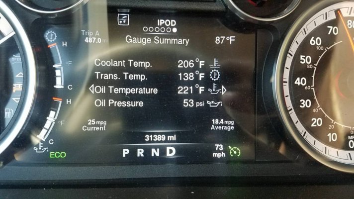

Went on a 600 mile trip over the last few days and I am impressed by how cool my trans runs in 80+ degree heat at 70+mph. This is about where my temps hovered the whole time. This is about 7 or 8 degrees cooler than it has run in the summer on long trips before the MH pan and Redline C+.3ead177c69b85b33b631d141c9210d6b.jpg
I did notice that when I had the AC cranked up my trans temps creeped up to the high 140s but immediately came back down when I turned the AC off. I'm assuming this has to do with the trans cooler and AC condenser being an integral unit and the extra heat from the AC condenser is bleeding into the trans cooler.
If I was going to tow heavy in the summer I would definitely be looking for an auxiliary cooler and probably just bypass the factory cooler.

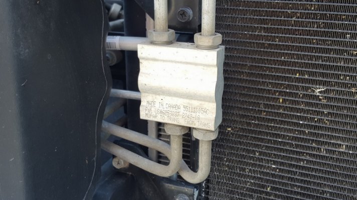

I wish my transmission ran at a lower temp. I actually added a cooler in series to the OEM unit without much of a change. This is the TBV on my truck:

I'm beginning to think that only the 6 speed trucks in colder climates got the TBV. Maybe a build with the block heater triggered the inclusion. I'll be removing mine shortly as I'm not happy with my trans temps while towing.
The TBV bypasses the OEM cooler up to a certain temp at which point it begins to open. It's apparently fully open at approx 180* and allows ATF to pass through the OEM cooler. Once it has cooled the ATF to a certain degree it again restricts or stops flow to the cooler.
RysRam
Aug 11, 2016
198
177
Ontario, Canada

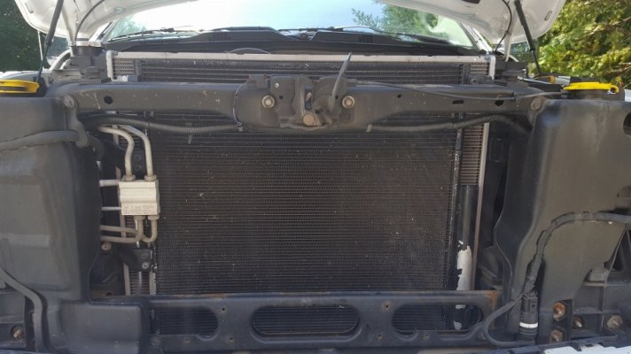

Can you guys check to see if you have one of these on your trucks?
It's basically a less elaborate version of the system on the 8 speed trucks. I was told during a ride & drive a few years ago that they were installed purely as a carbon credit measure.
I'll go look right now...
I believe I have this bypass valve and I believe it's normal operation.
If he has the 6 speed maybe the internal parts are incorrect or he has the wrong bypass valve ?

Maybe you have the wrong TBV or your valve is stuck partially open all the time , or doesn't open till way too hot ?
Have you tried changing out your TBV or disassemble & clean it ?
Sent from my SM-G900V using Tapatalk
My part # is correct for my truck. First thing I checked lol. The possibility that mine doesn't work properly is definitely.....possible.

To all , in an attempt to gain #s on the 2013 + 6 speed xsmn temps .
Please list your average temps of your 6 speed xsmn .
I'll start .
Winter = struggles to get to 125°
Summer = 135 - 140
Towing = my highest was 155°
