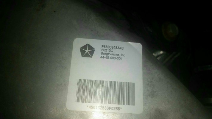

Just confirmed the Redline C+ is good for the transfer case on the BW 44-45
Sent from my SM-G900V using Tapatalk
Hemi395
Mar 18, 2013
9,507
17,683
Cape Cod MA

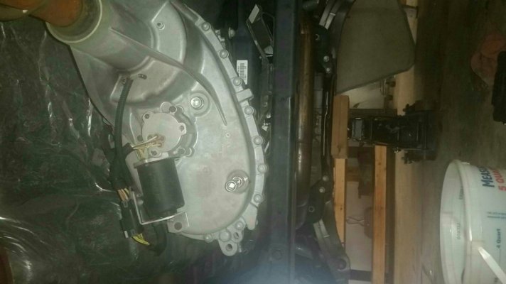

I have the 44-45 Borg Warner Xsfer case . Didn't you service yours with the Redline C+ ?d31b9d664f8469de0e34ffad43cc67f8.jpgeb90b57cd7e92f94da41baf127489397.jpg
Nope I had to use the special Mopar fluid. I talked with Redline tech support and they recommended against using C+ in my BW44-44 because BW has very specific frictional specs for the 44-44. I did try Amsoil SSMVATF in my 44-44 because they said it was spec'ed for the 44-44. I ended up dumping it and putting the Mopar fluid back in because clutch engagement was delayed and just didn't feel right.
But in your case with the far superior 44-45 you should be good with C+
