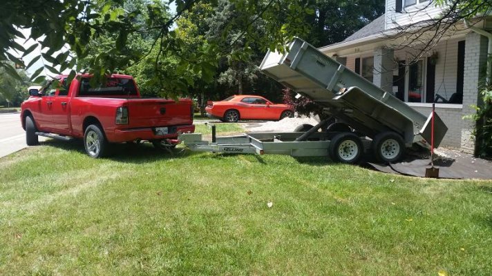

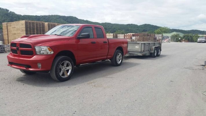

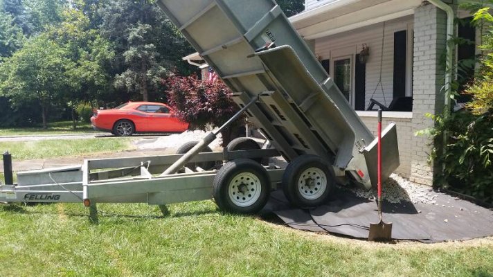

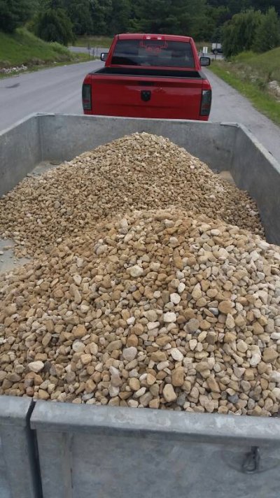

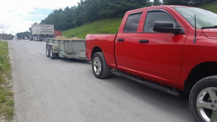

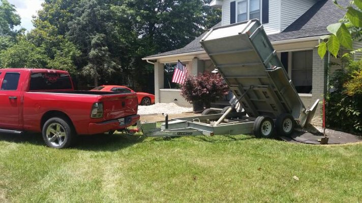

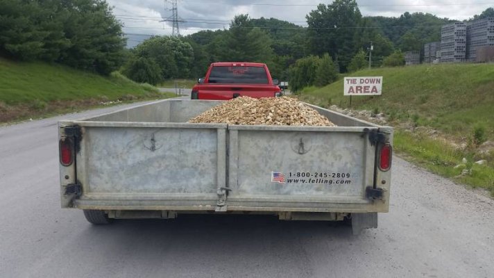

Today I hauled 6750 lbs of rock .
I was using a rented hydraulic dump trailer that weighs a bit over 3,000 lbs , on the biggest load I had 4,500 lbs of rock , so about 7,500 lbs total weight .
My truck 2014 Ram 4x4 1500 5.7L & 6 speed auto 65RFE Xsmn , 355 differentials , I do have the Mag-Hytec extra capacity xsmn pan (approx +1.5- 2 qts) filled with Redline C+ATF .

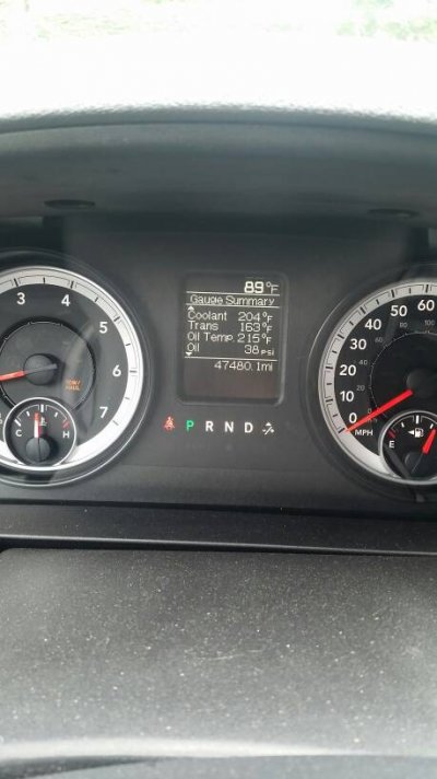

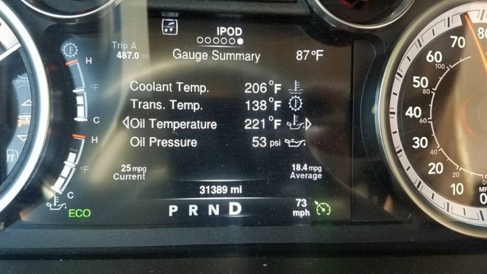

I'm in NE TENNESSEE , pretty hilly , my normal driving no load my xsmn oil temps on a 85-90° day is about 130-140° , today pulling the load of about 7,500 lbs for about 40 miles my xsmn oil temp while stopped got as high as 167° , but while driving & utilizing the oil cooler with Ram air the temps were just above normal @ 145 - 150 ish ° , not bad imo .
FYI when I was stopped at road construction for about 10 mins the temp went from 150° to 167° while I was in park ....I shifted to neutral in an attempt to get the fluid moving to cool it off , but it didn't drop at all ( 2 mins approx) , I then shifted to Drive , and the temp dropped pretty quickly to 160°
I didn't get a picture of the highest temps , but here's one I did take .
And a few other pics as well .
The truck pulled the 7,500 lb load like a champ , even up a couple decent uphill grades ..very happy with it , but I do wish I had 410 -456 diffs .9c82c6b8490975b615629010f1340d76.jpgd933bf016e20685461eaa44d9622978c.jpg44a653776cf7e3c53c511e95edfd2e0c.jpg6118c4bdb74967e3a876f120b727a0d9.jpg05822dcb97f80acee78d1a386113655a.jpg
Sent from my SM-G900V using Tapatalk

Happy to hear another good redline c+ atf experience. The "put it in neutral to cool the tranny" thing has never worked for me either.
And when i saw them load it like that i would have been like" wtf? You couldn't dump the gravel in the MIDDLE of my trailer?" LOL THEY favored one side heavily.
R.L.K.
R.L.K.
Dec 1, 2013
12,803
12,508
Bristol , Tn.
Yep , I wasn't to happy with the loader .. the trailer is rated for 9300 lbs so it didn't make a difference as far as I could tell .

Couple more pics .
79a5ee835425ca26287ff8810d24946d.jpg011cf98d2d7c1e7df55a1754b2ff0229.jpg96154d1b0f9265ddac1b4ffffdb18275.jpg

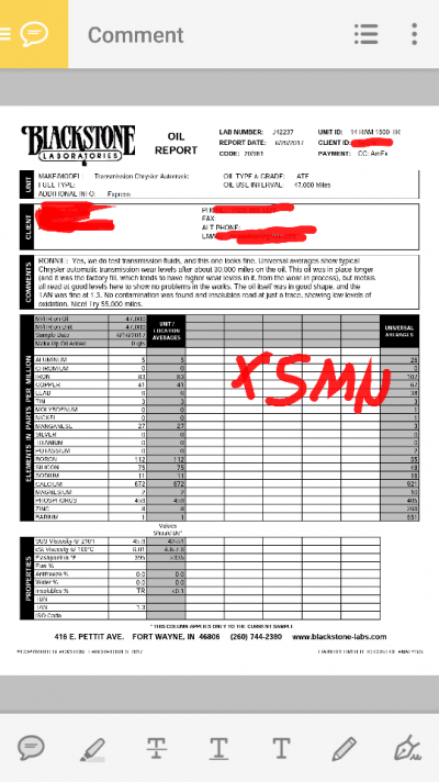

Here's a copy of my UOA , of my 65RFE XSMN with 47k on the factory fill
