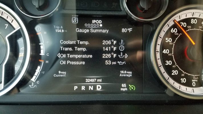

The wife and I picked up our new 21' TT this afternoon. 3100lbs dry weight. It was about 80 the whole trip and my trans temps never got above 145*. I think this is where the MH pan and Redline C+ really shine which is under load. I couldn't believe how cool my transmission was running.133106f69c1bbbd71a3ce118c7a8d7c2.jpg

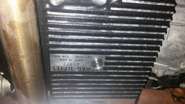

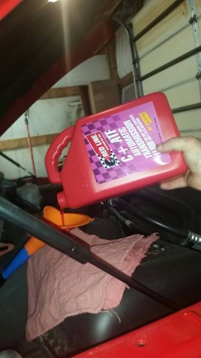

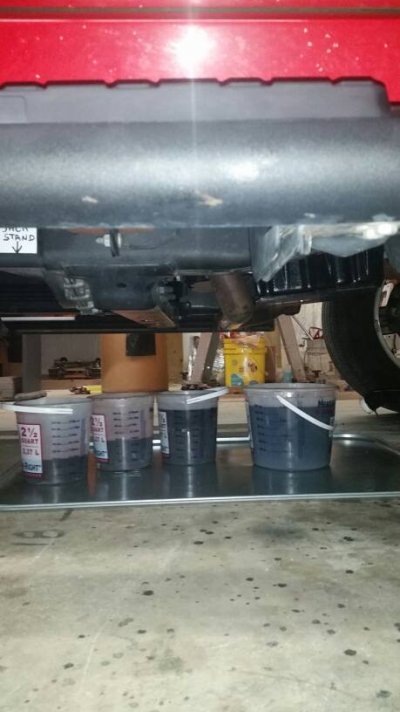

Today I drained & refilled my XSMN oil , AWESOME ! Just under 8 qts .
About 2500 miles ago I installed a Mag-Hytec Xsmn Pan with a drain plug , I serviced it with Redline C + ATF then , today was a pre planned attempt to just get closer to 100% Redline C+ in my XSMN , I may do one more next spring then at 25 k increments for me ...

my temps while towing 4,000lbs just a few weeks after the FIRST ( iv done 2 now) fluid change are EXACTLY the same as durring daily driving. On OEM it would have gone from daily driving (172) to 180 easy.

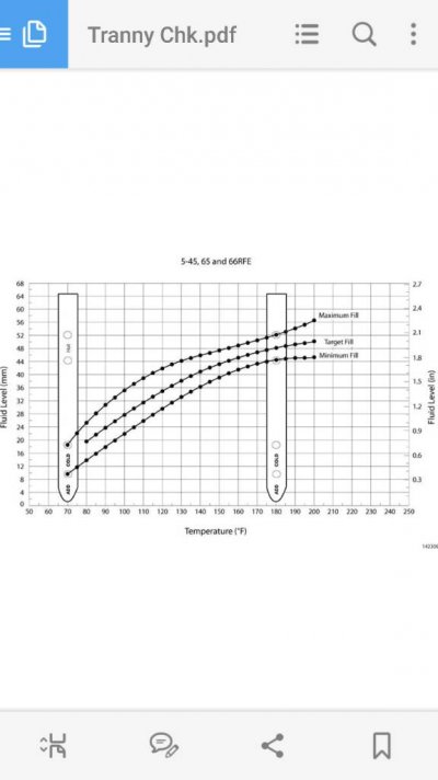

Check this out
Reactions: U&A
R.L.K.
R.L.K.
Dec 1, 2013
12,803
12,508
Bristol , Tn.
Based on this I'm a bit low
