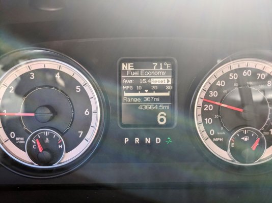

Selecting 6th gear with the gear selector will show what gear the trans is shifting through on the dash. Also will disable mds.
I tried that and actually do this every time I drive the truck to avoid the mds but my truck doesn't show what gear I'm in regardless. It constantly shows 6th gear when I hit the gear select button.
Yea thats odd for sure. My ‘16 shows what gear its in.
My '17 shows the gears with 6th selected. I'm in the same generation as yours.

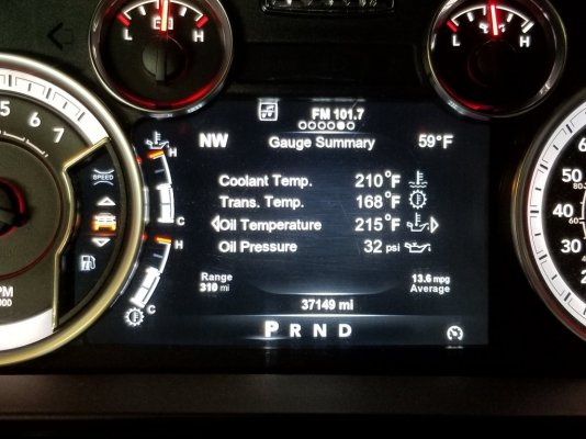

That display is the basic evic. That is what came in mine and he is right, it only shows the gear you put it in. I now have the premium evic in mine they will show a lot more info on them.

It’s the evic they put in the lower trim models like the tradesman

Ahhhhhhh maybe thats why then. Seems dumb they would change it to only displaying the gear selected when getting the lower model dash…figures.

Yeah mines a Lone Star package. Something they do for Texas area. It's basically a tradesman with power drivers seat, 8.4 Uconnect and remote start. Rest of the truck is a Tradesman.
I am not sure but I think I see what gear it is in but only when my display is on speedometer. I will try it and see but I know I have see it display it before. I keep mine on info all the time and there I know it just shows what gear I select.
That's interesting I have not looked at that display. I'll check it out this afternoon.
