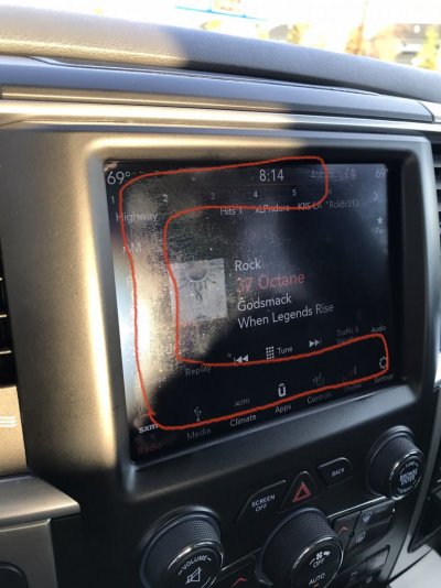

D652DD23-1FD8-4233-942E-E82B2A0C908E.jpegIt’s difficult to get it in a picture, when the sun hits it directly it’s bad. Other than that it you can’t even notice it

Apply one of these after cleaning the screen. It should hide those blemishes in the factory screen protector. The OEM screen has a very soft anti glare coating on it and this happens to all of the newer radios in a very short amount of time. You should apply it with either the HVAC bezel removed or the entire radio out of the truck as this protector goes under the bezel and covers non viewable areas of the screen as well.

Thank you for the reply! I just ordered one. A few month ago I put the mopar one on but it was very glossy and I peeled it off after a few days of having it on there. I had the bezel out when I added my brake controller so i can do that pretty easy
