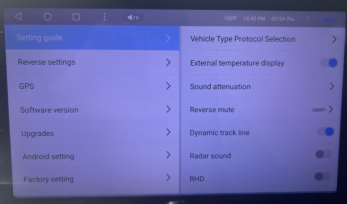

Maybe it's because mine's a different model? Dunno. It seems to work ok though.
Here's where that setting is in my unit (in case yours is different):
Car Settings
System
Setting Guide
Reverse Mute - set to open (attenuation cuts the volume in half, close mutes it)
