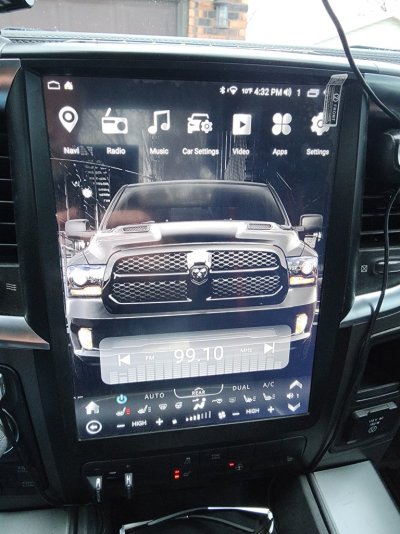

I'm looking at the Junsun and the Phoenix Automotive screens.
It looks like the Phoenix may be a little faster and reviews say it's better built, but I don't know anyone who has it. I can live with the Tesla style screen as long as everything works properly. Then again, I like that the Junsun lets me retain my knobs. Definitely need some advice before I pull the trigger though.

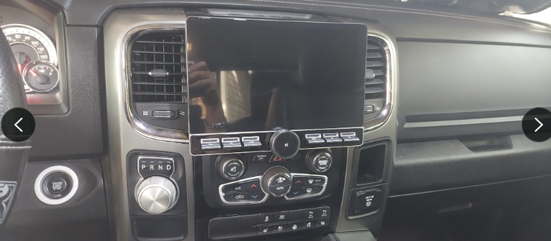

Couldn't really wait around because I'm only going to have a small window of time to replace it with my schedule, so I pulled the trigger and picked up the Junsun 10.6" radio. I couldn't find any reviews on the forum for this particular one, but it was cheap enough for me to gamble it. Not sure how I will feel about the screen sticking out a bit, but I couldn't get a radio with more than 2GBRAM, 32GB ROM in the 9" screen with auto AC and the OS takes up a lot of space. Figured I'd take the gamble. Plus I have a software engineer on staff that exclusively works with Android so if I run into issues he can hopefully help me solve them.
(This isn't my truck, but a screenshot of what it should look like.) I'll try to snag some pics of the install.

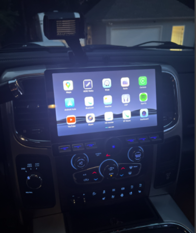

Installed the radio over the weekend and I have to say that this thing is awesome. I actually like the screen more than I anticipated. Installation wasn't really that difficult and everything is plug and play.
Every feature that the 8.4 Uconnect has is still there and fully functional, minus Sirius XM, but I have the app and once carplay fires up it auto loads Sirius. No difference, really. The thing that I thought I didn't like at first was the stereo sound but after realizing that I needed to go in and tweak the EQ, everything sounds even better than factory.
If I have one gripe, it's that the reverse camera is kind of weird now because the of the screen resolution. It's a little stretched, but nothing that is really a big deal. You can still see everything clearly. IMO, if I were looking for an aftermarket head unit to replace the 8.4, I like the brand so far. Time will tell how well it holds up.

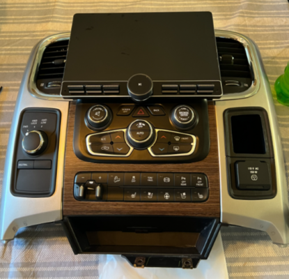

It's not removable any more than the OEM. You actually have to physically disassemble the center panel and attach the radio and the black center panel insert into it's place. The radio is made onto the black panel that houses the HVAC controls and the volume knob. You have to remove everything between the screen and the accessory buttons/trailer brake controller and move it over.

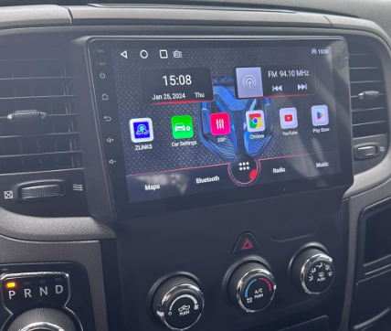

I love my Phoenix! I know some have had problems but mine has worked flawlessly. It was pretty easy to install and comes with everything I needed to install. I have a 2017 1500 Sport RCSB.

The Phoenix units retain factory control function. 2017 Sport RCSB

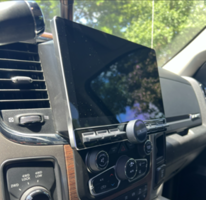

I think the smaller 9" Junsun would look more factory, where the larger one that I installed looks more like the newer radios in cars today. Big screens that don't fit in the dash. It doesn't look out of place, though I was really concerned that it would. If I could figure out a backup cam that would correct the stretching of the factory one I'd likely replace it.

I have a '12 ram, and I think it's the 14 and newer that have the bezel like nlambert's. mine sticks out a bit, easy to rip off, I didn't get the junsun one, I got another chinese brand one cause it had more ram, more space and at the time the junsun and the rest were Android 12, and this one is android 13.
in retrospect... shoulda got the junsun one. This one isn't bad, but it's frozen on me a couple times, it hasn't turned on the alpine amp a couple times, it doesn't dim very much when you dim the cluster lights like it should and I have played with all the settings. I've chipped the right side top and bottom corners some how. I had to use an adapter to get the factory rear cam to work, and initially it wasn't bad, but a 480p image stretched to 720p, but the camera quality has really dropped recently. It gets cranky with google maps, well there's been a few updates since I tried last, it seems sluggish. The steering wheel controls do work, for the most part. the hvac controls don't.. but I think that's cause I have a '12. Sound quality... I think it's actually better than the stock head unit. FM reception is weird, in the city where the broadcast tower is, reception is quite crappy, but I drove 100miles away and reception was still crystal clear... soo odd. And there's no AM on it. The power button just mutes it. If you drag the top down there's a moon icon that lets you turn off the screen.... but the screen comes back on when backing up.. when backing a trailer at night it would be lovely to be able to turn off or dim the screen.
I did look at the Phoenix, but at the time it too seemed like a knock off junsun. Would I do it again, yes, but I'd pay the $300 CAD for the Junsun instead of the $200 CAD for the brand I have.

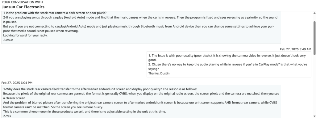

My radio doesn't cut off in reverse. I can't recall where, but there's a setting that you can turn off.

Well it isn't that simple. There are two tabs that lock the knob onto the board. You have to strategically pry those tabs up through a small window using a pick or really small flathead, and then use a pry tool to pop them off. It took a decent amount of work to get them off. Don't try prying without lifting those locking tabs are you'll shear them off.
Yeah, I've got it turned off...still cuts the audio in reverse. I contacted them, and they said it's normal.
