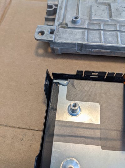

Hey everyone. I wanted to send an update. I received the eBay replacement screen today and was able to swap them out utilizing an extremely helpful video on YouTube reference earlier in this thread (I believe). I also used this opportunity to replace the thermal pads as suggested by SitKneelBend.
Pictured here is the original screen showing delamination:
The new screen looked very good and has LG branding but who knows if it is actually an LG product. The only questionable thing I saw was a collection of clear glue (I'm guessing?) in the bottom corners on the back of the panel. I assume this is cured LOCA? It was solid when I probed it so I'm not too concerned this time.

Looks like cured LOCA. If it's hard or rubbery then its either been repaired already or the LOCA overflow was the factory defect. Either way with the fully cured LOCA, delamination should not be an issue for you.
I suspect that overheating is the cause of screens starting to get ghost touches (as well as accelerating delamination). With the thermal pads installed this should prevent overheating and extend the life of the radio. If you really want to keep it cool, you can get crazy like I did and wire in some fans too...

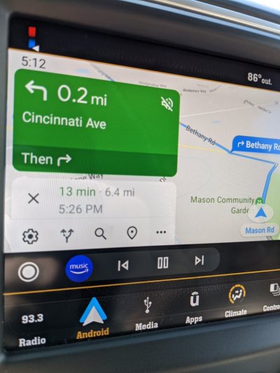

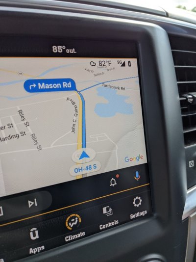

Looks like I spoke too soon. I noticed these "halos" when driving around tonight. See the lower right corner and the left side of the screen. I imagine they are permanent. It's pretty disappointing. I suppose now I'll have to contact the eBay seller and see what options I have. Have you guys seen this happen before? Will it "break in" with more use?
There was a sticker on the screen that stated, "Please note that sometimes after sealing the edges there is a chemical reaction that causes the screen to have spots and some discoloration. That will disappear with hot and cold cycles caused by weather over time. Again this is the only way to prologue (sic) the life of these screens."
Not sure I buy that.... Thoughts?

Interesting. Seems like they are now providing refurbished screens. Couple the LOCA you pointed out with their statement and it sounds like they are now repairing delaminated screens and selling those in place of the factory damaged ones.
It sounds like their disclaimer is describing your screens condition. I'm not sure if I'd want to sit on it to see though...to me that looks like backlighting illuminating the LOCA from the side (maybe?).

OK, I think I know what they did. They "fixed" a delaminating screen by injecting new LOCA into the screen to fill the gap, then sealed the outer edges with more LOCA that stops the old bad LOCA from leaking out.
In my opinion, its not a proper fix. And that bubble wont disappear because the good and bad LOCA won't mix. One will harden and the other will remain uncured. I'd return it. If it's the seller I sent you I apologize. That's not what they were previously selling and not what the description was previously. It appears they added that they "may have a small leak"...
