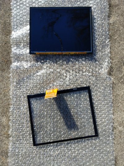

Well it was worth a try but ghost touches and screen unresponsiveness is back.
This is not to say that the screen delaminating isn't able to be fixed with the aforementioned process, only to say that re-laminating the screen does not fix whatever is causing the ghost touches.
I now know that re-laminating the digitizer and/or removing the factory anti-glare from the digitizer screen will not fix whatever is causing ghost touches.
As far as re-laminating the screen goes, the fix looks pretty good. I'd be interested to see someone try it on a screen that is delaminating but did not have any ghost touch issues.
I did notice some circular shapes on the screen after re-laminating, but only on bright screens like navigation. I wonder if they might be visible curing marks from using a small UV flashlight vs a large UV lamp which could have cured the whole screen at once. These were not at all visible on the normal dark background on most of the radios display areas and I'm not sure if they are actually marks on the anti glare coating from all of the cleaning and solvents used.
One final thing, I noticed that my slight misalignment made for a tighter fit and a slightly brighter more visible backlight on the display. To avoid this, I'd recommend placing the screen back in the radio after applying the LOCA, but before setting it to cure. This way it will settle in and cure in the intended installed location. At the very least it should be taped in place or better yet clipped into the metal housing of the radio with the black metal screen retainer.
