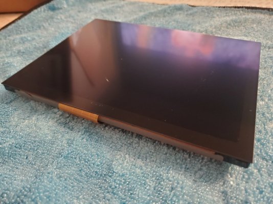

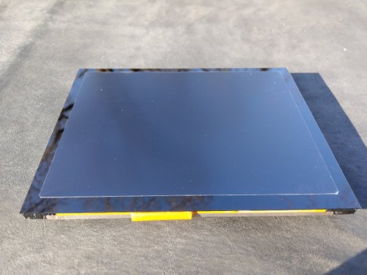

As for finding screens from Chinese sellers, all were either fake listings or they wanted more money after purchasing at a lower price they hadn't updated yet.
The damaged eBay screen turned out nice though. I removed the scratched anti-glare screen with Goo Gone, a razor blade and glass cleaner. Then applied a matte Bro-Tect screen protector to the bare glass. Very happy with the results, the Bro-Tect is the best matte screen cover possible in my opining (I don't know how they aren't more popular).
This...
To this...

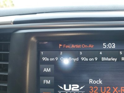

Same here, 2018 and it looks like this today. The top left corner is slowly getting worse. Does anyone know if there is a way to stop it from spreading? 20210427_170302.jpg

Same here, 2018 and it looks like this today. The top left corner is slowly getting worse. Does anyone know if there is a way to stop it from spreading? View attachment 245734
You can try to purchase a cheap UV flashlight to try and get it to cure the glue but in my tests the glue (LOCA) will not fully cure on these bad screens.
Thank you, if I try this how long should I leave the light on it? Do I have to take the radio out? I actually have a uv light already. I appreciate your help.
If you can make the light stable/supported with the radio installed it should work (if it's going to work at all. The area that's visible is pretty much all of the area that can be cured.
As for time, good LOCA cures very quickly. It sets in under 1 minute after activating and should have a full cure within 3-5 minutes. That said, this is bad LOCA that didn't cure properly from the factory. I personally would let it go overnight and remove the radio from the truck just in case the UV light has any effect on the plastic trim.
Note that while the bubble is at the top, the bad LOCA will actually be flowing out the bottom of the screen (it's "draining" out the bottom).
If you want to try to completely remove the bad LOCA I'd be happy to help walk you through it (my previous posts should get you there though). I suspect that so long as the screen hasn't started ghost touches that it's possible to repair the delamination completely but I have yet to get a screen to try it with.

Quik update, so I tried to recure with the light ,no good. This is today , 2 months after my first picture. Thanks to SitKneelBend I was able to purchase the parts to attempt the repair. I will update when I receive everything and give it a shot. 20210630_073601.jpg
