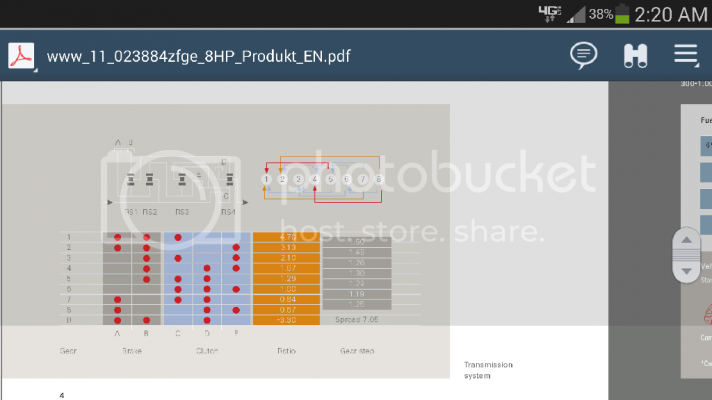

Right. but it also cuts the heat down significantly. It appears through my readings that the 8HP70 can lockup in any gear from 1-8. There also seems to be multiple clutches for certain gears. 3rd gear just so happens to be the first gear available that has two clutches. They also have gear steps which I find odd.
