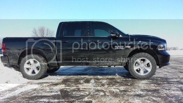

Thanks again for all the help bud! I'm sure it'll work itself out. I'm just thinking its locking up as should but I may be either applying throttle or letting out of the throttle as its locking up causing more of the sensation.
Love the tires! This is my 5th set of Duratracs lol. Here's a pic of how she sits leveled now.

nice tires
it looks awsome man im thinking of the upgrade as well but im not sure i wanna sacrifice any fuel enconomy looks great tho
Thanks man! Surprisingly my MPG has dropped maybe .2 mpg. They're a pretty light tire.

14
275/65/20. One size up essentially from stock. 34.07".
