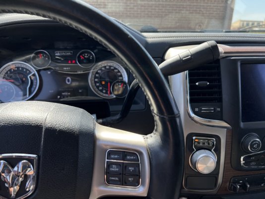

I wired everything up following this diagram. When I try to start my truck it won’t start and my PRND lights are all illuminated yellow and the electronic shifter will illuminate P. Then intermittently my dash will show only P in the normal colors and bounce back between. When the push to start is in run without the truck running (it won’t crank) my rotary shifter shows P as well as my EVIC. I believe I either have my CAN C lines going to the wrong place. I wired them into the CAN C lines coming off the RF HUB. I think that’s the issue. Only other thing I can think of is I should wire the CAN C lines into the shifter instead of the RF HUB. But I don’t wanna start splicing electronics until I know where what goes and vice versa. Also the ignition pink/white wire, where does that wire into? Can someone whos down this guide me in the correct direction? Need my truck running before Monday morning

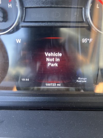

My evic is showing that the pcm doesn’t see the transmission is in park yet my rotary shifter shows only the P illuminated. I need to figure out where to tie my wires into so the pcm gets that signal from my tcm showing it’s it park like my shifter does.

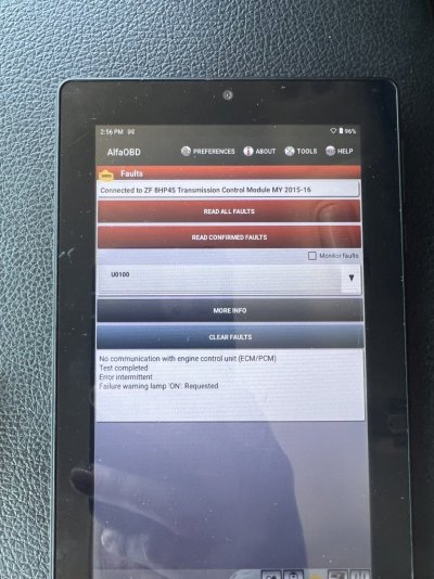

Pics from the reading I’m getting from my transmission

I found this and wired into the CAN lines off the pcm. I no longer get that pcm and tcm no communicating error. It’s just my truck doesn’t think it’s in park… Yet it is in park. Intermittently all letters on the dash with go from yellow to just the P in silver illuminated. image.jpg

I got a 2014 8 speed pcm from lkq. Then I went and got a new brake pedal sensor and voila my truck starts now!! Thanks everyone for your help. Now lol the next hurdle is I shift the rotary shifter from P into R/N/D and the selector moves but the illuminated light stays on park. I’m guessing I need to add more transmission fluid? Thoughts?

So after about 2 days of driving my truck died on me. I started getting service electronic throttle errors and then my truck slowly over the next 2 days would start then idle like it’s about to shut off and I got no response from the pedal. I believe it was due to the pcm being from a wrecked truck or vin mismatch or something. So frustratingly I found other means of transportation. Over this 2 week period I ordered the 2013/2014 8 speed engine harness with the 8 speed transmission plug. I finally got around to installing it and my question is my old pcm that came with my truck still looks for the rfe transmission. I can’t change this in the pcm or atleast I don’t know how to. I changed it in the bcm but my truck still says not in park. Is there a way to change this or do I have to purchase a new pcm?
