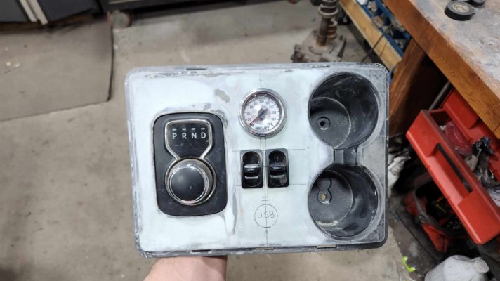

First coat of fiberglass done. Now time to make a mount for my Air Lift gauge and controller in the empty spot.

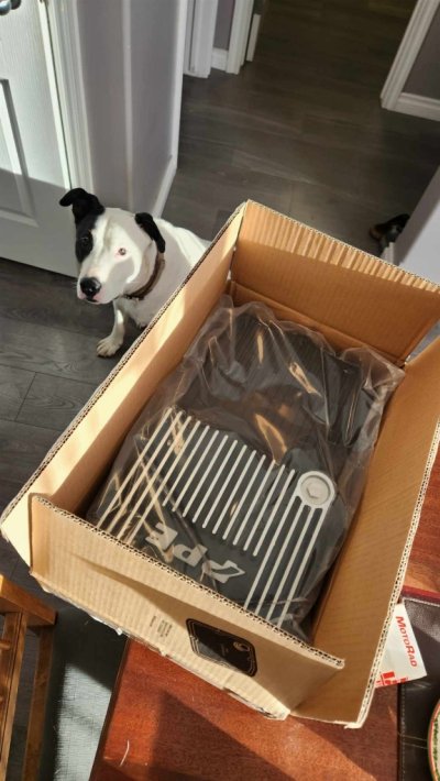

And the PPE pan just showed up... lol... Never realised the cheapest place I found it on is in Lloydminster.
SGA Kit shipped today :dogpile:
8 Speed with 63xxxkm on the way as well

You're cruising! Nice work in the dial shifter grafting! It looks almost natural there, doesn't it?

Productive day . Just put a coat of Ever coat light finish bondo. Should be able to sand, paint and prime tomorrow.
Glad this is out of the way. :biggun:
