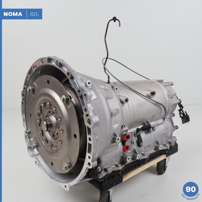

With a little adapting you could probably even make a generic cable work.Here's a pic of the Jag's cable.

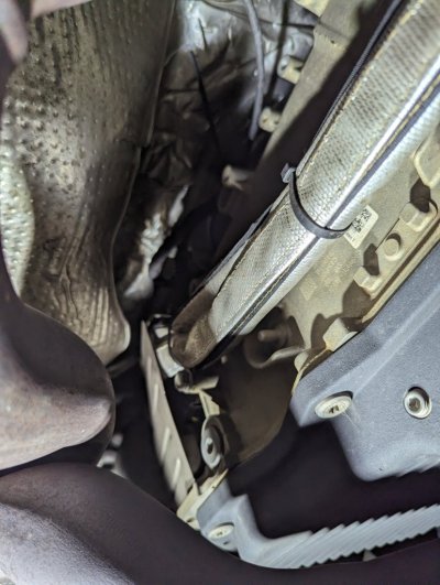

I never installed the neutral bracket. Never felt the need, honestly. I actually used the location to install the transmission cooler thermostat.
I think you'll be plenty fine without it if your new transmission doesn't come with it.

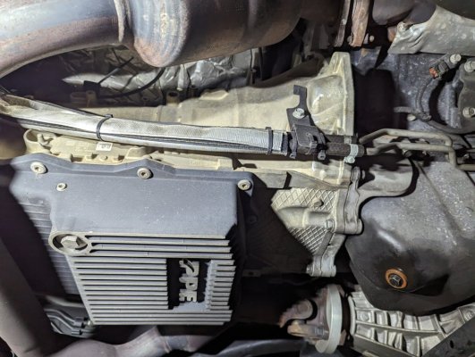

I wrapped the cooler lines over the top of the transmission, going reward (as you see in the pic) and then on the other side brought them to the front, and used heat insulating fiberglass. I'll grab a pic this evening on the other side for you.

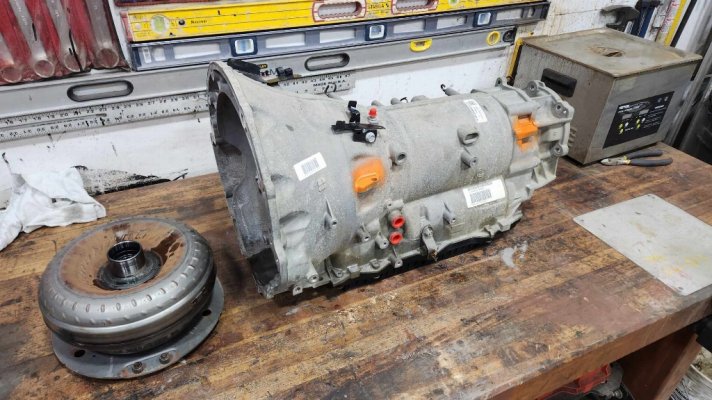

My truck made the round trip to LLoyd to pick up the 8 speed... lol...

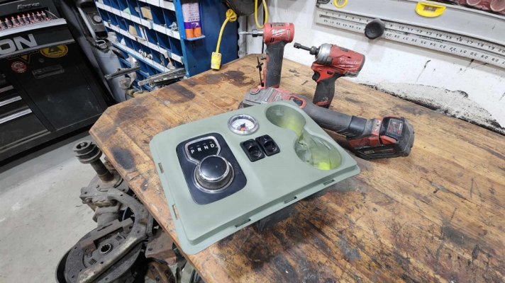

The bezzle is acid etched primed, Just waiting on the USB plug . rather drill it out before paint.
So now im back to the waiting game. According to Mopar Parts Canada they wont see half my order for 2 weeks minium as lots of the parts are B/O

Looks like your transmission did not include the bracket for the neutral cable. My installed transmission does not have it either so I don't have one available but if I were you I would just use a screwdriver or prybar in the event you ever had to pop it in neutral, or source a bracket and cable from another 8HP70 family. I haven't had to force it into neutral yet and if I ever have to, I will just crawl under it and use a prybar. At least your truck is lifted instead of lowered.
