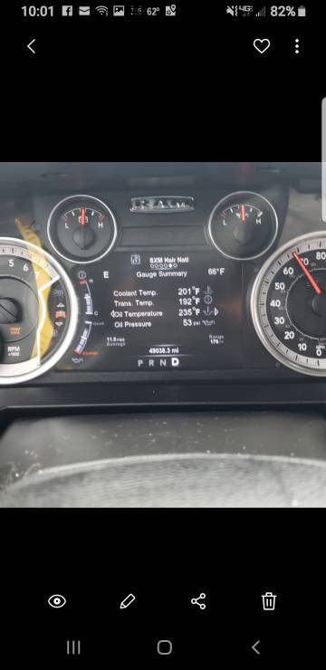

I have a 2015 1500 and it seems that all temps run a little hotter. This was pulling a 7k TT3adb09a7a6238d570272846729505c03.jpg

for the 8 speed, if the transmission temp is below the coolant temp and is not making drastic temperature spikes above the coolant temp it's working correctly. The usual operating temp range reported is 175° to 192°F
