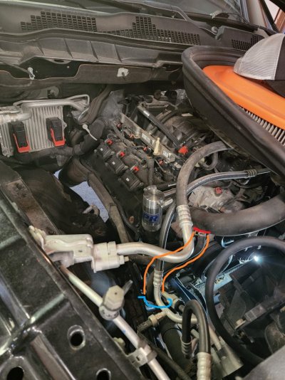

Mine has been deleted for about a year now. I see no difference in the trans aside from colder "high" temps. Meaning I'm no longer seeing 200 plus degrees in the summer. Now it stays in the 150-170 range. When it's below freezing here in Ohio I still see the exact same trans operation as when it was stock.
For the record I used the previous bypass thread to gather that the coolant (heater) lines didn't need to be plugged at the trans. I ran a hose from the waterpump to the lower radiator hose. (Orange line) I originally planned to block them off but haven't gotten around to it yet. You could go with a Gates #23604 lower radiator hose that doesn't have the fitting for the trans heater. (blue line) Then a thermostat housing from an earlier model. (Red line)20220415_173327 - 2.jpg
For the record I used the previous bypass thread to gather that the coolant (heater) lines didn't need to be plugged at the trans. I ran a hose from the waterpump to the lower radiator hose. (Orange line) I originally planned to block them off but haven't gotten around to it yet. You could go with a Gates #23604 lower radiator hose that doesn't have the fitting for the trans heater. (blue line) Then a brass plug in the water pump. (Red line)View attachment 511651

If you swap to an earlier thermostat hosing and the heater lines for a 5 or 6 speed truck,you can get rid of everything that was at one point in time hooked to the transmission.The earlier 8 speed trucks just have the standard thermostat housing with no fittings on it,they also have the frame mounted 3 way valve,which i just unhooked,but left the electrical connector hooked to it,so it didn't throw any codes.Your truck being a 16 i don't think will have the 3 way valve,so the heater hoses off the 5/6 speed trucks will clean up alot of extra unused coolant lines.If you want to remove the cooler lines totally,the easiest way CrazyKid and i found to remove them,is to cut them into pieces.
Yea I mis-typed in post #25. I said the lower hose and water pump. I meant lower hose and t-stat housing. I'm going to go back and correct it. I plan to eventually switch mine out. Probably the same time I finally get my cam installed is when I'll do it since the cooling system would be drained then. Like you said, mine being a 16 it didn't have the electrical valve.

I already ordered the new tstat housing. Just need to order the lower hose and cap the hole in the water pump with a threaded fitting to completely rid my truck from any potential leak points
