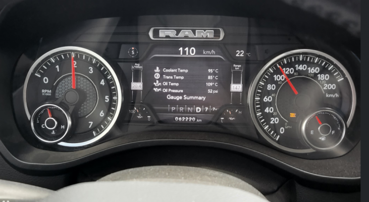

Adding a different flavor to the thread. Over Thanksgiving holiday drove from Virginia to Tennessee to visit family. Drove down late Wednesday night early Thursday morning, outside temps were in the 25 to 29 degree through the elevated portion of Virginia along interstate 81. My 8 speed, with chaulk's part installed provided for trans temps of 109, as a low for about 3 hours of the 7 hour trip. Avg speed was around 80. After dropping out of the elevated terrain on the western side of Knoxville temps climbed back to 120 and stayed consistent. I have all active grill shutters out except top and bottom rows.
On Saturday before returning to Virginia for work, I reinstalled all of the lower grill shutters, and left the uppers out. Temps this week with the weather in the 20s on the 20 minute trip to work are running 132 to 139. A much more acceptable range.
My trans has always run cooler even before chaulk's part install, however I'm thinking 109 might be a little cool.
Opinions?

@hawsk99gt I think that would be a good experiment. It looks like the transmission operating temperature is highly dependent on the ability of the trans oil cooler to cool it down once the trans thermal bypass plug is installed.
Also, if you haven't already, I think you should consider doing a transmission fluid level check per the procedure @Wild one has distributed (the infamous green instructions). You wouldn't have to change the majority of the fluid or drop the pan. You'd only need one quart of the stuff from the dealership in case you need to top off, but in all likelihood, you might not even need that, since there's a good chance fluid will actually drain out if you follow the procedure correctly, since it seems these transmissions may be over-filled at times (which is my concern here).
Following the procedure isn't a walk in the park, but it's also not rocket science. Many of us here have perfected it by now an would be happy to walk you through it. You'd need to be able to jack up the rear end quite a bit onto jack stands for the 1-2 shift (turn traction control off, back tires will need to spin). Also, wear gloves (fill plug is tight and near exhaust pipes), and get a way to pump the trans fluid into the fill hole (again, only if none comes out during the level check in the procedure).
I think doing a proper trans fluid level check would give you some peace of mind at the very least. It'd be one less variable you'd have to consider in your quest to diagnose the problem.
