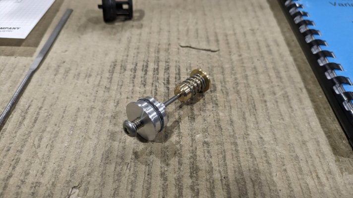

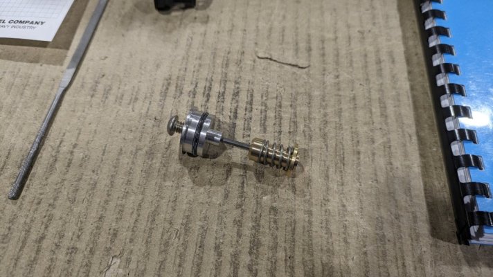

Not a new version, but an optional add on. I still need to verify fit and function in a TMU, but I'm certain it's going to work.
For those who want or need to replace the factory plastic cap. Only for use with the bypass valve.

I would like to be the first to buy and try.
Jesse's cap ("metal plug") is going to most likely be a money saver, compared to buying the RevMax set up, and be of the same or much better quality.
I'm interested in purchasing Jesse's(@caulk04)metal plug when he makes note that he is taking orders on his supplemental transmission thermostat by-pass kit.

Jessie. You sob!!!!!!!!!!! That looks beautiful!!!!!!!!!!!
I will probably keep my stock one. BUT my dad has a 22 5th gen Ram and I've been wanting to install your bypass but didn't want to fool with that black cap again and mess something up. Because it's his truck and not mine. You know what I mean..
This would be a awesome solution.
