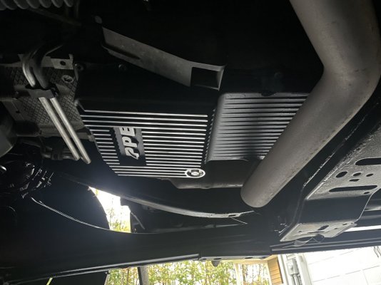

Hey All, I wanted to post my experience with doing a fluid and filter change with PPE pan.
My truck is a 2020 2500 6.4. I bought it in the spring of 21 with 600 miles on it. I have 86300 on it as of today. Probably 10K or more is towing either my 9k TT or car trailer with various weights on it. The rest is commuting miles all over New England.
The transmission has been awesome to date and I wanted to keep it that way for as long as possible. I decided to use OEM fluid and have a local performance shop do the work. He also insisted on using the OEM fluid and was fine with the PPE pan. The $250 it cost to have them do it was worth it to me as they have done this a few times before. I found a kit that had the pan 10 quarts of fluid and gasket for $650.
My confirmation bias says the trans feels much better now than before the change. I’m very happy with the way it went. The mechanic got me a sample of the old fluid and said it was worth doing from the look of the fluid and I would agree. IMG_2421.jpeg
The transmission temp always stays at 168 degrees once up to temp under normal conditions and would get there in around 20 miles. While towing I’ve seen it at 173 or so at its highest but would drop right back to 168.
Today was the first trip with new fluid and pan. On my way in normally it would reach 168 about half way to work. This morning it got to 150 by the end of the 40 mile drive. On my way home this afternoon it reached 165 at 3/4 of the way home and danced between 165 and 167 the rest of the way. So definitely running bit cooler and taking longer to warm up. IMG_2422.jpeg
I beat myself up on wether I should do this or not because it isn’t cheap and they say it’s lifetime fluid and all that. There are cheaper ways to do it but I like the piece of mind this gave me. I plan to do it again at 120k mile or so.
Also the pan was for ZF 8hp 70 and fit the 75 no problem.

Did they level the transmissions pan rail when they filled it back up? It's a fairly important step on the 8 speed ZF transmissions,which alot of shops don't do.

I sure hope they did, I asked if they knew the procedure and wanted to know if they understood it’s not a typical transmission service. I was planning to do this myself so I had done a bunch of research prior. That procedure list was something I saved a while back from here. They said they’ve done a few BMWs and Rams with ZF transmissions before. I left it at that.
I didn’t sleep good the night I dropped it off to be honest haha

Just for peace of mind,i'd jack it up till the pan rail is level and recheck it,easier and cheaper then having to replace the transmission,because it's down on fluid,lol
I don’t think that’s a bad idea at all and i think i will this weekend. I just feel like I paid the money for professional service and I shouldn’t have to check their work. I’m a master Electrician and decent wrench. I could have done this myself but believe in hiring the right man for the job. Maybe part of larger problem.

Hey quick update on this. I did end up double checking the fill level on my own I was a little over half a quart low. Likely chance they didn’t level the trans when filling it back up as they said they did. Wild one was right on double checking. Or I just over filled it haha. Time will tell.
When I do this again I’ll do it myself, it wasn’t hard at all, as many have said. Just jacking the back up a mile was interesting. Im also a bit slow burned my hand a few time despite being fully aware that were ways around that.

You'd basically have to hang the truck straight up and down by the back bumper to overfill the 8 speed,lol. I think you're good to go now :waytogo:
