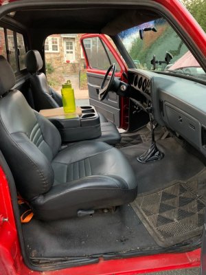

Hey all, I Have been restoring this 1991 Dodge W150 with the 318 and 4-speed auto. When I bought it, it had been sitting for about 9 months but it ran and drove just fine for about 20 miles.

Very nice looking truck ! Hope you solve the issue, And please update us !
