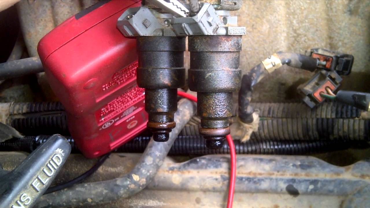

For your symptom I'd check fuel pressure. There is an internal intank filter
on the return less system that started in 1994. An issue with these era of engines, especially since alcohol added fuels, is rust in the fuel rail from water settling there. The rust will break off and clog injectors making it run bad or not at all. I did a YouTube video long ago demonstrating an injector that fell victim to this.
Just a suggestion. Also a bad O2 will not stop it from running.
