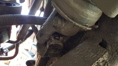

So i have a dodge ram i bought a 3 weeks ago. At first it wouldnt start with out a obd2 plugged in. Found out it was a ground. That needed to be fixed. But why i try to read codes with the obd 2 it will not read any codes. It comes up with kwp 2000. Also i have a loose steering wheel problem where it gas alot of play. Found out problem but i dont know if i can fix it with out getting a new part or i need a new part. Ill attach pic of it

The steering is a common problem, many have solved their problems by either replacing the steering box, or putting a heavier duty bracket on. Sometimes both are required to achieve desirable response from the steering.
