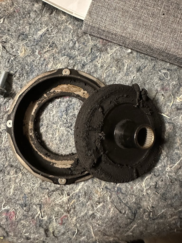

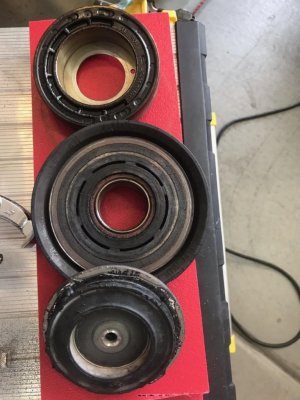

Replaced my clutch recently and this same thing happened to me about 200 miles in. Did your replacement clutch fix your issue? I'm wondering if I just got a cheap part? Got it off ebay, new part, not refurb.
Pictures below. That is supposed to be one part. the vulcanized rubber just melted and therefore the clutch plate would not spin.

Did you properly set the clutch disk air-gap? This is accomplished by removing or adding shim washers inside the hub. Removing a washer or installing a thinner one closes the gap. I set them to .015-.020" using feeler gauges. Incorrect large gaps will let the clutch slip causing it to overheat and melt like yours and the OP. The clutch wears and can be reset to stop this from occurring if caught in time.

Check seal on front of compressor if u see the black grease of death its shot. The seal wears out then the lubricant comes out of compressor coating clutch in turn wrecking it.

thank you for the idea. Yes, I did check the gap with a feeler gauge, and it was within tolerance (after adding an additional shim). I checked it and rechecked it the best I could with the awkward access. But now I'm second-guessing myself and wondering if that was it. I was confident it was good because the clutch engaged/disengaged in what looked like an effective manner, post-install. hmm

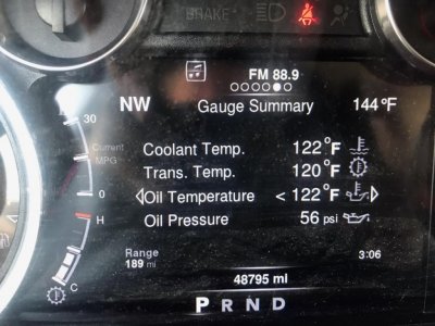

I still have the pulley on, so it seems I can't get a good look at the shaft seal on the compressor, however, it looks like from the picture below (pulley still on truck so I can drive it), there is no oil present.
