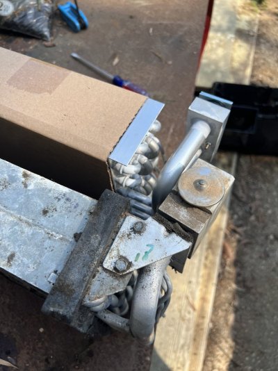

I purchased a new evaporator and heater core for my sones 89 W100. Finally got around to pulling the box from under the dash and both parts are wrong. I’ve been looking online but it seems none of the evaporators pictured match up to the one I have.

If you're referring to the block with the round disc on top, that's the expansion valve, either transfer the old one over if it's good, or replace that with a new one also

yes I know about the block, I just didn’t have a T30 socket to get it off. The evaporator it’s self doesn’t match and that’s what I can’t find.
