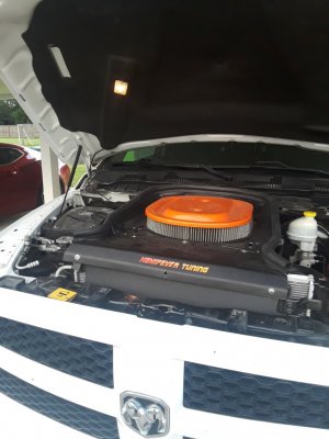

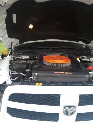

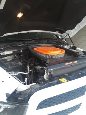

I have the opportunity to truely test out the difference in the Vararam and old style S&B(well modified S&B) thanks to my neighbor. He bought a Vararam for his 2018 QC from a local friend of his.
*Disclaimer before I start my S&B is the old style which I modified. I moved the coolant overflow tank over slightly to where the grille shutters(removed shutters already) used to be & cut the scoop of the S&B a few inches shorter to catch air from where the overflow tank was. So its not your normal S&B. Nobody seems to like the new style S&B & they also did away w/ the scoop so with that said if I had to buy new NOW I would get the Vararam.
So we put it on & went for about an 8-10 mile test drive. We did normal driving, wot from a stop & wot from about 50 on. So far my overall performance impression is..........the Vararam performs the same as the modified S&B. Down low is the same. From 50+ it is about the same, it may pull slightly harder but not by a marginal amount. I am going to leave it on & drive it to work the rest of the week to continue to feel it out. And IF, thats a big IF, the tracks are open this weekend(has been raining everyday & we have a hurricane that will be passing just north of us tonight) I want to do some track testing. If not I dont want to hold the intake ransom from my neighbor too long.
Now to the bad.....my overall impression w/ appearance....it looks cool but man this thing is FLEMSY!!!! The S&B's quality is far better. There isnt even a contest.
We will see how the track times are IF I get the chance. If not I will dd it for a few days & give it back to my neighbor
Until then my truck has a Vararam intake hooked up, the S&B box still mounted, tuned by Jay Greene with a Hemifever sticker under the hood.......thats some serious horsepowers right there I tell you what....lol

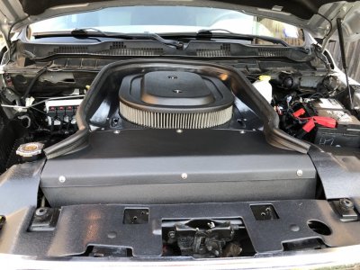

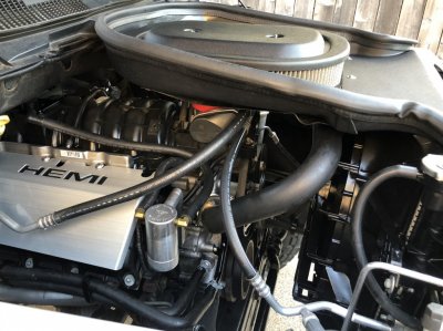

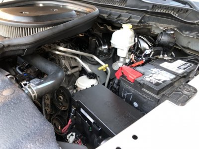

Excellent review, @Gary's Hemi. To the larger group, I keep hearing people talking about the Vararam lean. I have a 2010 and don't have the issue. Is it product quality or year-specific? I wonder.

With the 2 I have had on different trucks I haven't experienced the "lean" problem either????????

Arizona
View attachment 139611 View attachment 139612 View attachment 139613
It's caused by the 2 A\C lines running underneath the Vararam. I guess some trucks are different with the height of those
lines as mine is a little high on the left. I believe Matt made a video that included how to adjust the bracket on the passenger
side fender to make everything level....

Call me crazy, but yours looks like it's leaning to the right to me lol. Mine leaned a bit to the right until I saw Matt's video and actually installed it in the correct process order, which made a difference.
Crazy! :confused:
But I did re-watch Matt’s vid. He mentioned 2013+ Rams had the raised AC lines. But you did get me to inspect it again, between beers of course!
Haha I thought that too, but was like maybe its just the picture.
