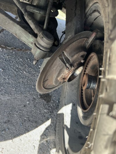

I have a 2018 ram1500, 2wd, harvest edition, 49k miles.
The ABS light came on and said to service my electronic braking system, shortly after I heard a bang, boom, pop, the wheel was completely sheared off, and all that I saw were bearings all over the road. Any idea what the heck happened??? I seen lots of post about ABS but mine actually went full blown boom.

Looks like a front hub seized on you.If one side went,good chance the other side is also probably due for a new hub assembly to.
