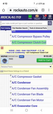

I'm looking on rockauto. I see a compressor coil. I don't see a clutch. Not saying they don't sell them. Maybe its just rockauto. But, it would almost be better replacing the whole unit, rather then the clutch anyways. But I know in order to do that, you would have to pull the freon out replace the compressor and then have the freon put back in. It's more work but if you can't get your hands on a clutch, you might have to do that. Do they have Pick N pulls in the UK where you're at? If they do, and maybe they don't since you posted this. I would just grab a clutch off of a Pick-n-Pull. Good luck man.

Hi UK Here's a site for your AC compressor, you're better off getting a new compressor, there's a bearing behind that clutch that probably on its way out, these guys will hook you up.
You're going to have evacuate the system and reclaim the freon put a vacuum pump to the system and change the dryer to do the job right there are others here that could help you further

Hi, thanks very much for the replies, I work for an ac company so I can get someone to take the refrigerant out, then pressure test it and put it back in no problem, I know the compressor itself is good so was hoping to save some £££ by just getting a clutch.
Used parts for theses are very rare in the uk.
I’ll order a compressor from Rock Auto now.
