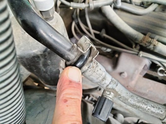

OK going on 2 hrs on the net,can't find a pic/diagram that ID s this? Thought it would be pretty simple.
SO...what is it,"special" tool needed for removal/install ?
98 1500 V8.
THANX gents !

this is a master fuel line and A/C line tool kit but auto zone carries the kit I think they are OEM brand that has just the four in yellow just for A/C line it clamps around line then slide it up into end of fitting to expand the release spring just pull off the retainer lock first Untitled.png

Looks expensive.
Rent ?
