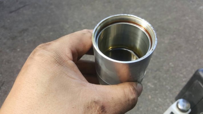

Ok so I did a little digging and the part in question is probably #4 in the pic below (52014804AG).
It looks like they are having a hard time with this line with now 7 revision of it (this part basically replace : 52014804AA, 52014804AB, 52014804AC, 52014804AD, 52014804AE, 2014804AF)
