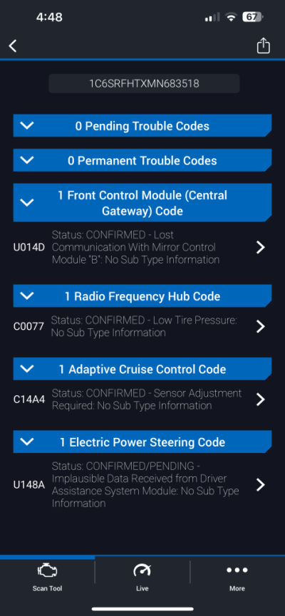

A few weeks ago I got a clean sensor message. I washed the truck and the message went away. A few days later I get service ACC/Lane Assist and Emergency Braking. I was hoping that the last recall would fix this issue but it did not. I have an appointment at the dealer next week but wasn't sure if there was something I could do in the meantime. I have tried to let the truck sit for 1 hr without the battery attached and that did not work. Any help is appreciated.

Disconnect battery for a couple of hours and reconnect. You can also disconnect both cables and touch them together to ensure full discharge. Also, open fuse box and press down GENTLY, on every fuse and relay to make sure they are fully seated. Both have been known to fix gremlins. Easy to do while waiting to get in to see dealer.
