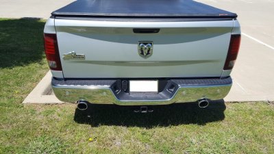

I loved the Sport LED tails, finally bit the bullet and ordered a set from Retroshop.
Man what a HUGE change....easy install with the plug and play harness. Took more time finding tools!
Note, best to pre-drill the rear wall behind the taillight, even self tapping screws were too tough. That's some thick walled material.

Its the kit from Retroshop. It comes with OEM Mopar Sport tinted tails. And 4 resistors and the harness. Pull the factory tails out, and predrill the 4 holes to mount two resistors behind each light. Mount them, and mount the grounds off them. Then one plug comes off those to the harness supplied by Retroshop. The two factory plugs plug into the new harness, and it plugs into the new tails. So you don't reuse old bulbs, they are all inside the new tails.
But talk about brighter...wow...much better, sleeker look too.
I literally spent more time getting tools together than getting these setup.
Looks OEM.
